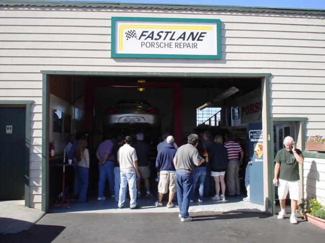

Did Tim Benson help you with that?
The tech session at his shop and wine tasting was last October. How about if you hit on Tim for a repeat this October.
Tim was in-between helpers so I pull out the transaxel and Tim installed the differential and I put it back in the car after he also replaced the rear main seal. Sure learned allot working with him.
The important point about the RMS replacement is that the engine had 3,500 miles since being installed. This a 3.4L 996 E-gas motor new from Porsche.
