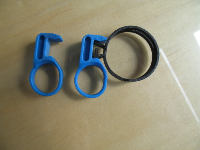

There is a spring band clamp that comes with a plastic blue thing that compresses the clamp so that the clamp is open. When the clamp is in position the blue thing is pulled away and the clamp closes. I have seen the mechanics use it so I took a picture.

I highly recommend using a spring clamp tool. It makes the job much easier. Then there is no need to cut the bellows. Here's the one I got (for $10):
"Craftsman Swivel Jaw Hose Plier"
http://www.sears.com/shc/s/p_10153_12605_0...05&sLevel=0
I also advise against replacing the spring clamp with a screw type one. The spring clamp automatically has the right tension and with the above tool it is pretty easy to put in place.

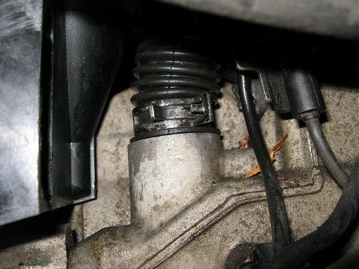

[Picture 1 is a] picture of a failed attempt when I tried bolting the AOS before putting on the bellows. I couldn't get the bellows to go on correctly. In this picture you can see how the AOS bolts in (2 bolts just under the joint of the mirror).
[Picture 2 is of the] AOS properly installed. You cannot see this through the wheel well without a mirror. I held the camera out to ensure that it was installed properly.

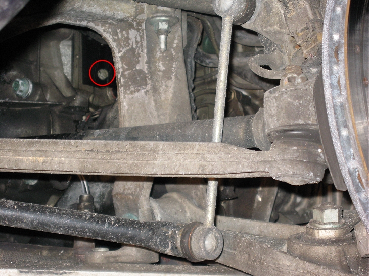

In this shot, the right rear wheel is off and the camera is actually outside of the wheel well. I have circled the lower AOS bolt. The upper one is a couple of inches above that, just barely out of sight from this picture.

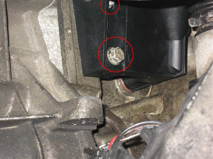

Here are both bolts, closer. You can just barely see the lower bellows in the upper right of this picture.

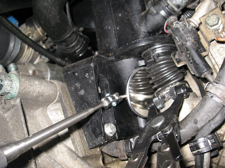

2. removing and installing the two 10mm bolts; This is a blind operation. Once you have the car lifted and rear tire off, sit in front of the disc brake as if you're going to bear hug it and reach with your left arm into the opening shown in Stefan's pix. Feel your way around. I always felt for the bellows first as it is the most distinguishing feature. Then use your new AOS as a visual reference to feel your way to the bolts. I didn't have much success with using a wobble or universal joint to help align the socket with the bolts (as mentioned Bruce). I used a short 10mm socket with a stubby ratcheting wrench.
3. removing the hose clamps and releasing the old bellows; a cable operated hose clamp pliers from Sears ( Sears item# 00947390000) helped tremendously. The head on these pliers are a bit large and it was difficult to get it aligned just right to engage the hose clamp but it can be done. It took me a good 1/2 hour of trying. I highly recommend having a helper to squeeze the pliers and lock them while you use both hands to align with the hose clamps.
