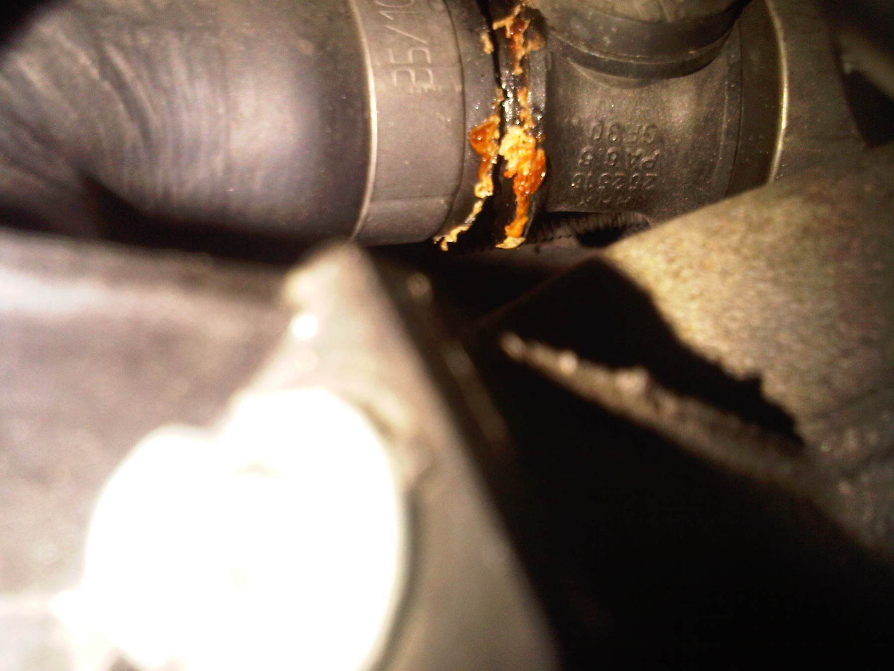

I had my coolant pipes replaced 13 months ago due to coolant leakage. Just when I thought life was good...Bang......1 month ago my car dropped all of its coolant on the ground.
Investigation revealed that there were two plastic T-pieces in the coolant system at the back of the engine, one of which had cracked.
The cracked T-piece was replaced along with the 2nd T-piece for preventative purposes. (CPO warranty picked up the tab :thumbup: )
Dealer tells me that they are starting to see an increased number of cars with these T pieces cracking.

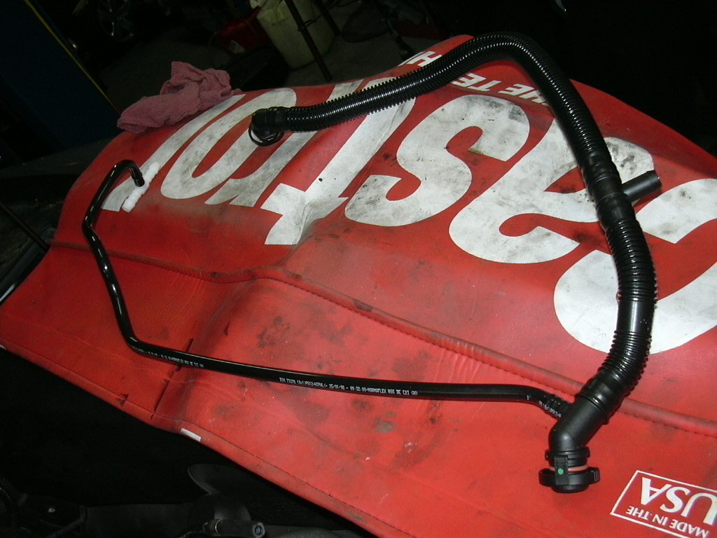

The pipe in the pic. is a ventilation/breather pipe, the brittle plastic water pipes/connectors are situated on the rear of the engine (between the engine and the firewall)

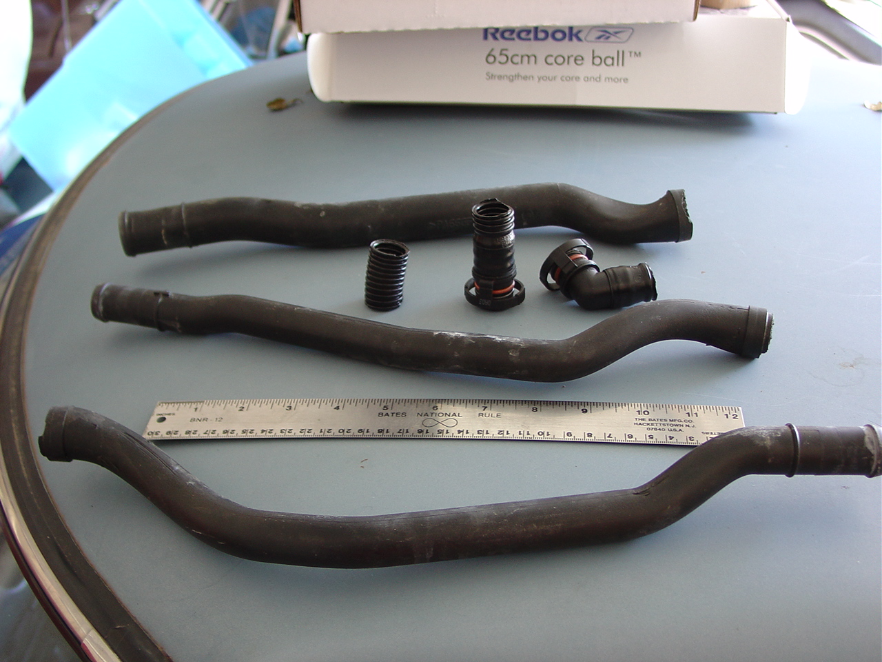

Please post pics as it helps other members identify the parts.
I hope these are the parts you are seeking. They are the only other parts in my box of parts the shop gave me.

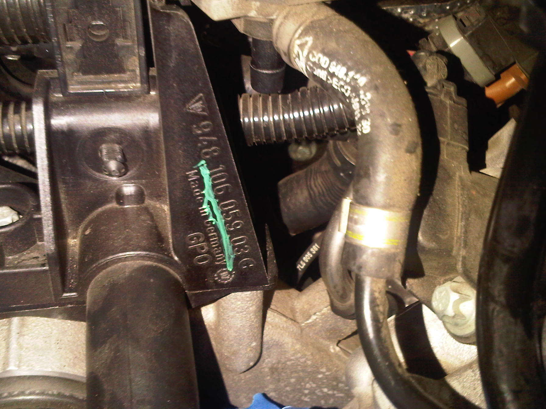

I just changed out my plastic coolant pipes for aluminum. Part of the kit is this plastic T into a vent hose at the back of the motor. Mine was broken and I could not find a single crack in my plastic coolant pipes.
This is a strange little T since it is plastic but connects two halves of a rubber hose with pressure crimped fittings onto steel lines. I almost replaced it with a metal one but it just did not make sense. Maybe, somehow, this little T is really the problem?!
You can see in the picture the gap in the rubber hose below the T. This is where it fits in. Notice the type of hose it is on either side of the T.

Yikes, is that a breather pipe spliced into a water pipe, or just a splice to feed cooland to the turbos??? Can anyone let us know why that (POS) plastic connector is there?
Andrew
Ignited posted a picture of the whole breather assembly in post #5 above. It's just a plastic breather hose that connects that T fitting to the valve covers. Look close at his picture and you can see the white T fitting at the end of the hose, that is the same fitting in my picture above.
Those pics kinda confused me.. I dont think that white breather pipe is the pipe causing the problem. Here are a couple quick shots of mine. I will post a better one as soon as I get the lil :censored: out.
One pic shows the plastic bracket that holds the 3 top coolant pipes at the back of the motor. Notice the right side of the bracket with the part #s on it. Just behind that area, connected to the rubber hose are the black plastic T pipes that split the hose in two.
My crack is pretty obvious in the next photo.

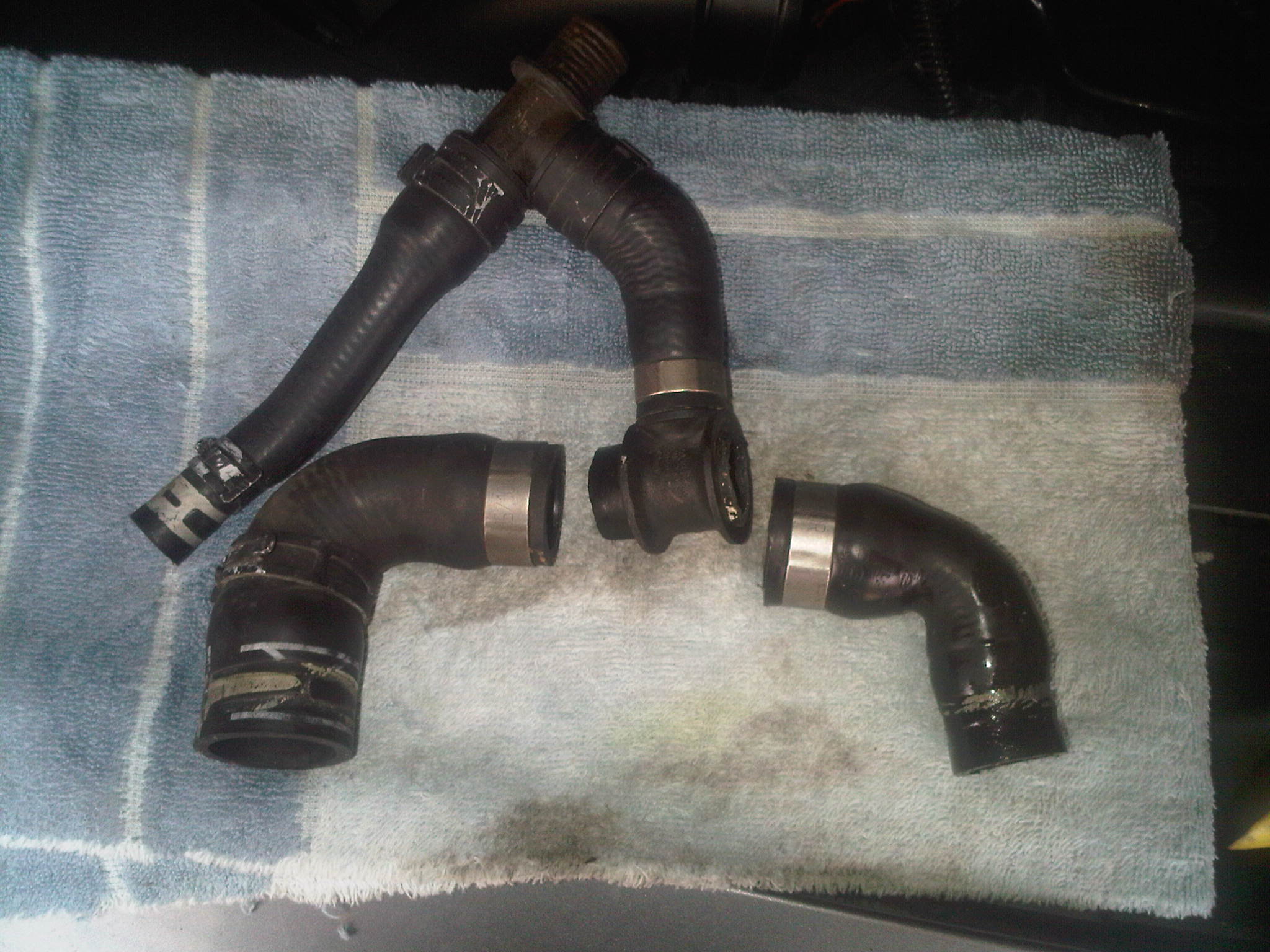

A few painful hours, a flashlight, post-58823-011663300 1278616933_thumb.jpa long pair of angled needle nose pliers, a knife, a small flat head, a long flat head and several busted/ scraped up knuckles and I finally got the bottom hose to the T-pipe out. The major problem I had was the hose had melted to the pipe so even with the clamp removed it wouldnt come off. So I had to slice and tear and twist and poke at it for quite a bit of time to loosen it.
As promised, here is a picture of both T's and their respective rubber hoses. My leak occured when the bottom T broke off of the hose to the left. The hose on the bottom right broke as I was removing it.
If you're going to do this yourself, be patient and persistent, and patient and patient.
Its going to be a real B*#ch to get that bottom hose back on securely.
