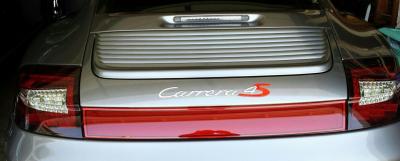

I am really interested in swapping out tail lights. Any update on availability of LED Tail Lights for 996 C4S (wide body)?
I wouldn't wait for the wide body LED tail lights. I think the bottom line is that there are not enough cars to make the tooling worth while. I
finally bought new factory lights since mine had broken mounting tabs.
I changed out my 3rd brake light to a LED strip.
Delreycustoms.com has leds for the widebody in 3 different styles Spyder brand but they are $835 including a needed harness.

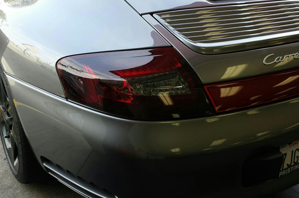

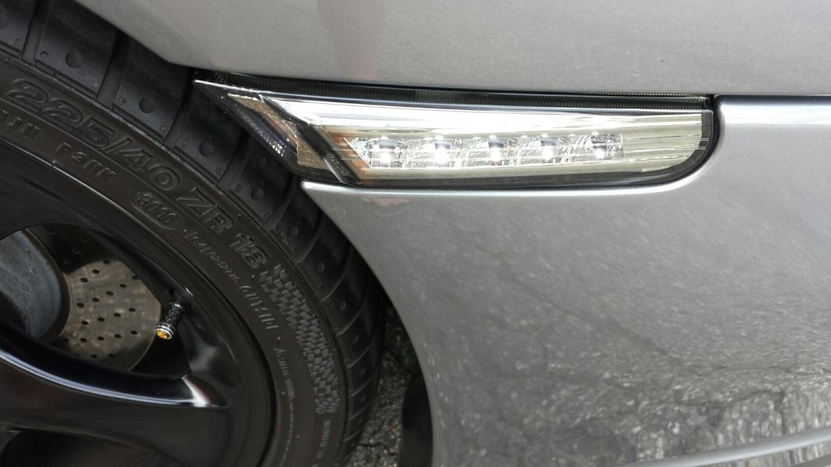

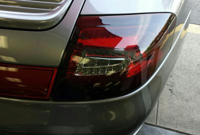

Just finished installing aftermarket LED Tailights, 3rd brakelight (both) and side markers...Plug and play no problems...Did it through DelRey Customs in Venice CA. Very Happy..a bit pricey about $post-101019-0-92613100-1428332796_thumb.1,100 for all....they come in 3 colors clear with red LED/ Smoke with red LED and Dark Smoke with Red LED. 3rd brakelight comes red lens with red LED (OEM) or smoke with red LED. Side markers are Smoke with amber or white LED....I did the smoke with RED and the side markers smoke with white LED..
just a followup..the red reflector on my 2002 can be smoked to match the smoke color on the LED lights..I may be putting a GT3 wing on mine which the reflector will then be removed...all in all i get nothing but compliments even from my friend who owns an independent dealership and wasnt too keen about changing the lights.
