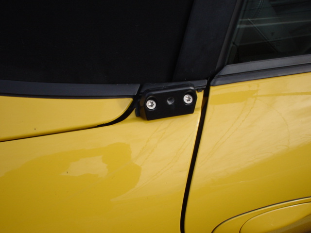

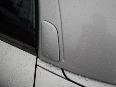

I had thought they were only for model year 1997. I have a 1997 and my factory hardtop has the ears. On the parts list it is listed only for a 1997.
But, we have a local owner with a model year 1998 with the factory option and he also has the ears.
For sure they were gone for model year 1999.
The purpose was to attach the roof transport system (RTS). Then Porsche changed the way the RTS attached and the ears were eliminated.
It fits.
All 986 hardtops fit all models.
All require spinlocks to be installed in the car.
The top with ears will mount the early roof transport system only and likewise the later only the later RTS.
Porsche issued a TSB on May 18, 1998, that explains the difference between the hardtop versions, and the new style RTS.
The RTS produced from January 1998 no longer included the hardware necessary to mount the RTS directly to the hardtop. Instead, you were to mount the RTS to the car with a hardtop the same way used for a car than only had the soft top. Thus, the reason the "ears" and hardtop hardware/adapter were eliminated.
The last sentence in post #4 is not accurate per the TSB.
I wonder why they went for a different system for fitting it to the hardtop in the first place, when it also connected to the car. Doesn't really make any sense...
