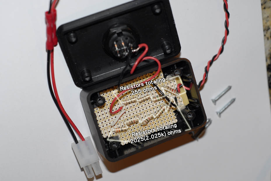

Using the schematic, I built this box. There are 2 strings of resistance: One which totals 255 ohms and one that totals 2025 ohms. The switch bypasses the 2025ohm section.

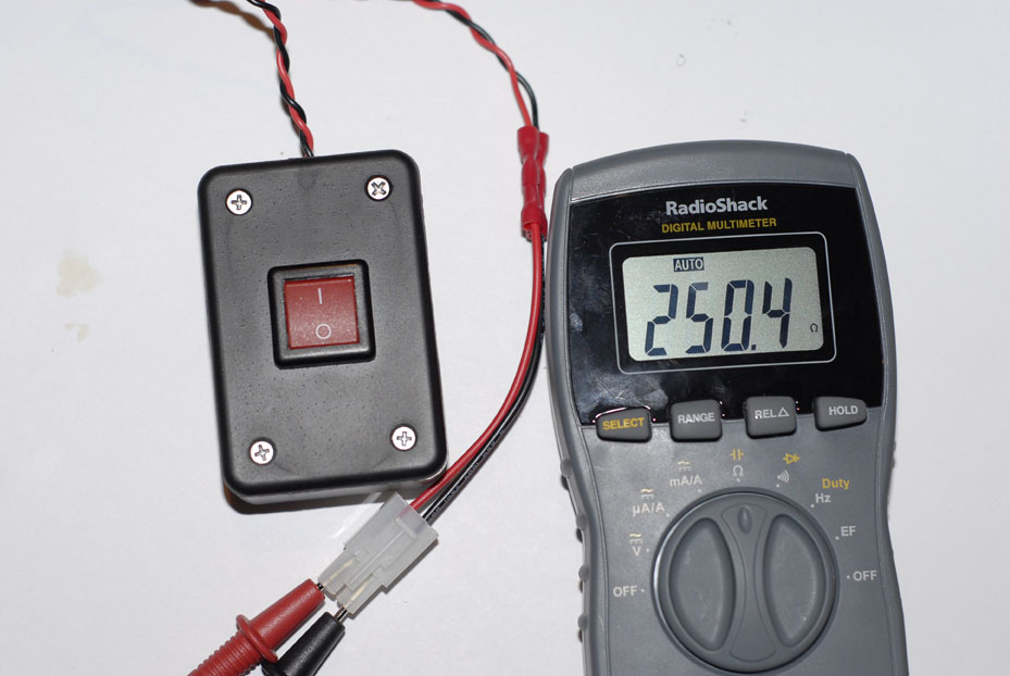

Here are the reading you should be getting out of the unit. This image shows the reading when the switch is in the "off" position which tells the system to turn off the airbag.
This image shows the reading when the switch is in the "on" position which tells the system to turn on the airbag.

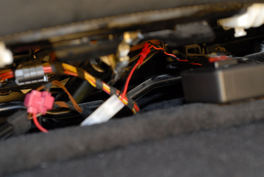

I spliced a simple connector into the wire and behind the connector for the Porsche deactivation bar which is located under the passenger seat. This makes it tidy and easy to remove later if you choose.
Here it is installed.

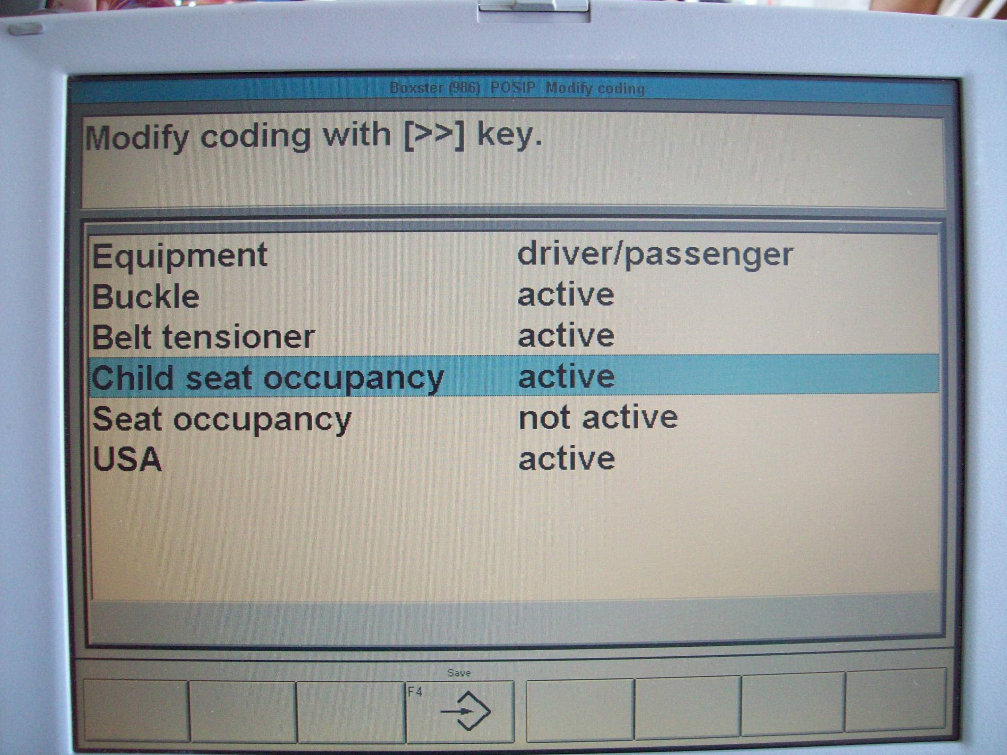

2) Once installed, the switch will not turn off the airbag and the airbag warning light will come on until a dealer plugs into the computer with a PST2 to tell the system that a device exists. Once this is done, you should be able to flip the switch and the airbag warning light will flash for 60 secs to let you know that the airbag is deactivated. This switch will not work until it is enabled in the computer with a PST2. This is the same as the Porsche child restraint bar.

Demick asked me to change the air bag coding so that the car thought it has the deactivation bar. But when I looked at his car he did not have it. He said something about using a switch connected to the center console lock.
After I changed the coding he locked it and the air bag warning light started to blink, then stopped. Just as if the deactivation bar was installed.
