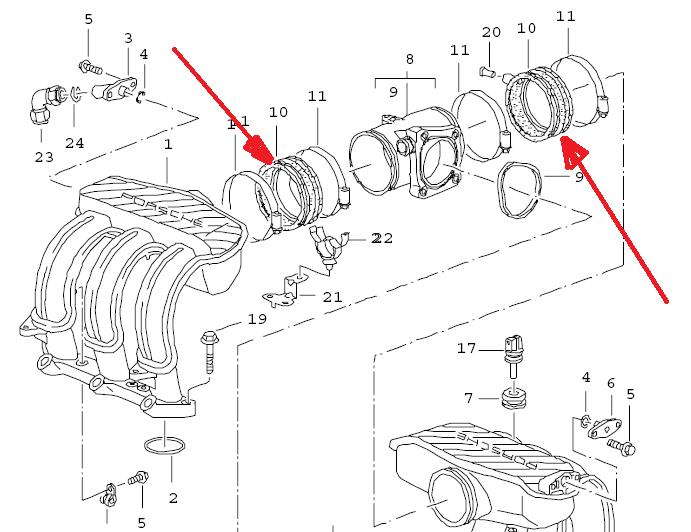

These Vacuum hoses are connected to the flexible rubber sleeve.
You should have 2 vacuum hoses, one on each sleeve. (see pictures)
You need to reconnect them to avoid a check engine light.

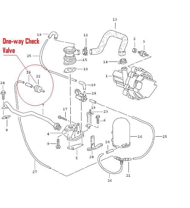

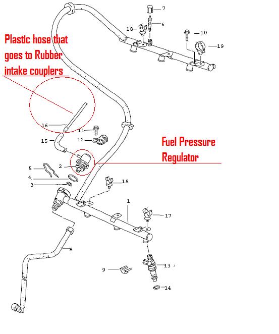

That image of the check valve with broken plastic tube in it looks like the check valve for the Secondary Air Injection system... And im pretty sure that ONLY the Fuel Pressure Regulators plug directly into the Rubber collars that couple the Intake manifolds together.
Heres an image of the Check valve on in a parts catalog image.... I dont know where the other end of he check valve leads to cause the image doesnt show where it goes from there.
and Second is the picture of the Fuel Pressure Regulator plugged into the intake couplers.
It could be that it is hooked up correctly but you have something in your Secondary Air Injection that is faulty and is causing your o2 sensor problems.
